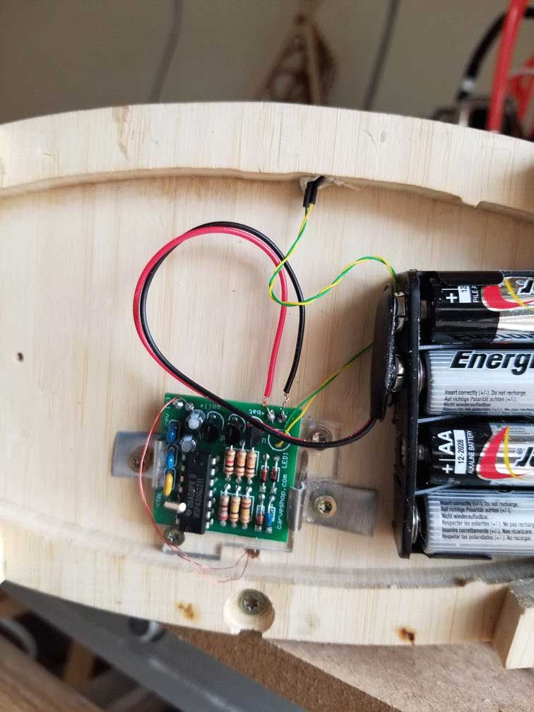

Getting a wooden gear clock to keep time is challenging, but the electromagnetic pendulum drive from Dick Bipes of Carveshop.com solved that problem. This PC board varies the pendulum swing to keep perfect time.

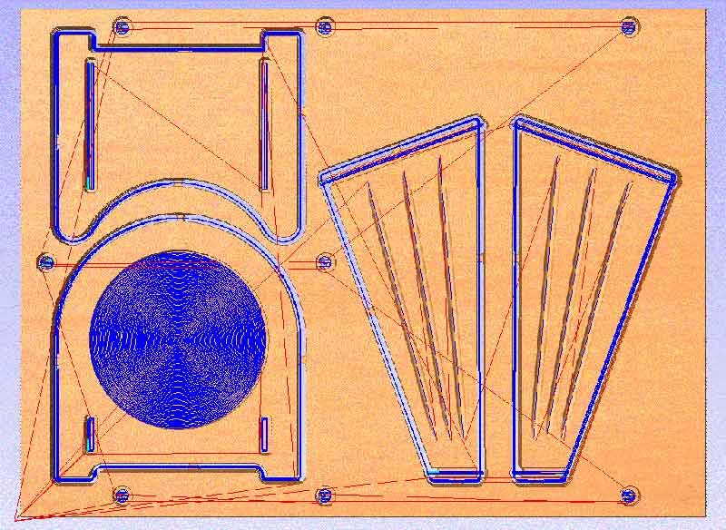

Originally, I designed in the Bricscad (Autocad lookalike) package and transferred the DXF file to Vectric’s Aspire for the tool pathing. But the Aspire package has got so complete now that I can create and toolpath everything in one place.
For the clock project, I do a spreadsheet with the ratios and number of gear teeth. Then from the gear gadget, one gets the PCD and hence the gear centre spacing. Then to the Aspire plan layout, with each component on a new layer. Aspire does not cater for plan and elevation well, but one does a sideways layout alongside the plan.
In the clock projects, most of the machining is with 3.15mm and 2mm straight shank cutters, with profile and pocket toolpaths. Feed rate is set at 2500mm/min, plunge 1200, pass depth 70% of tool diameter (2mm for 3.15 cutter), spindle speed 16000 rpm.
I screw the ply to an 18mm pine spoil board with brass screws. I program in the screws location with 8.5mm 4 deep countersink and 4mm screw hole cut with the 3.15 cutter. In the wine bottle holder project, one uses the fluting too with 4mm ball nose, and the 3.15mm ball nose for the carving.

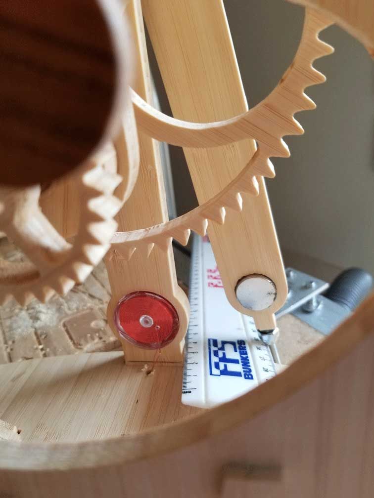

The gear shaft design from the purchased clock plans were inadequate. So, I started from scratch, and now use 5mm threaded bar for the shafts and 10 x 5 x4 ball bearings. The bearings are a little loose on the shaft, so thread seal tape is used to take up the slack. I use 12mm of copper water tube as a casing, which houses bearings either end. The copper tube is dimpled to retain the outer race. The bearings are spaced on the inner race by 6mm of copper tube, drilled out to 5mm. The 5mm nuts bear on the inner race without fouling the outer race.
Another challenge was the clutch mechanism to permit the minute hand to be moved. The trick here was a felt pad (like one you would use under chair legs) glued to a disc, which is bolted to the centre shaft. The disc presses against the centre wheel with a small spring.

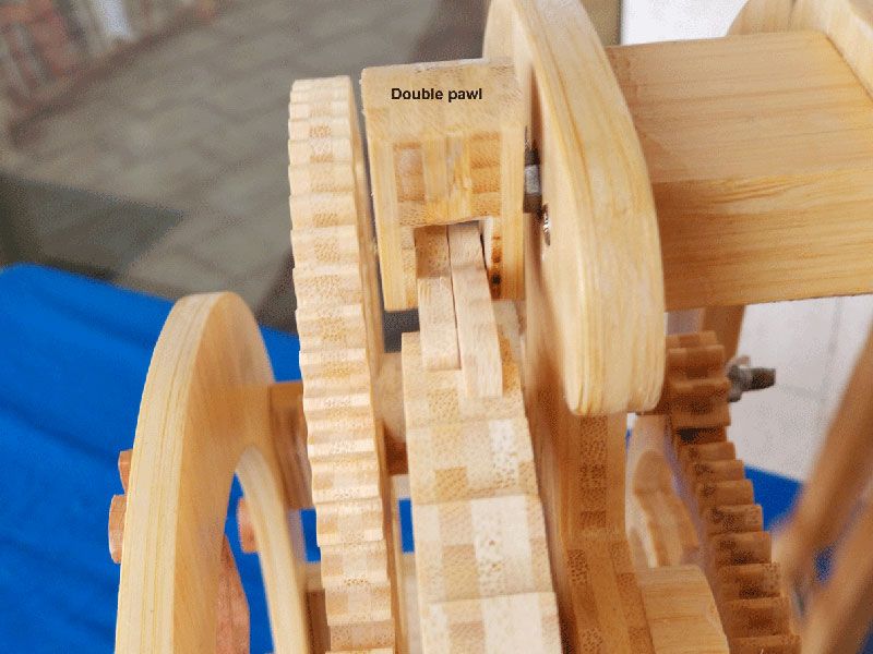

Coping with a variable amplitude swing of the pendulum which drives the ratchet is a problem. Dick Bipes designed a clever cam mechanism which was too challenging for me. I designed a dual pawl system to drive the ratchet wheel, but it is rather difficult to describe it here.
