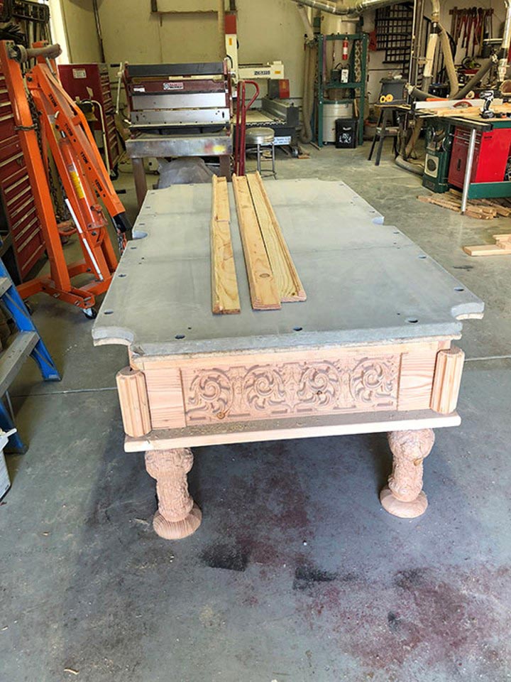

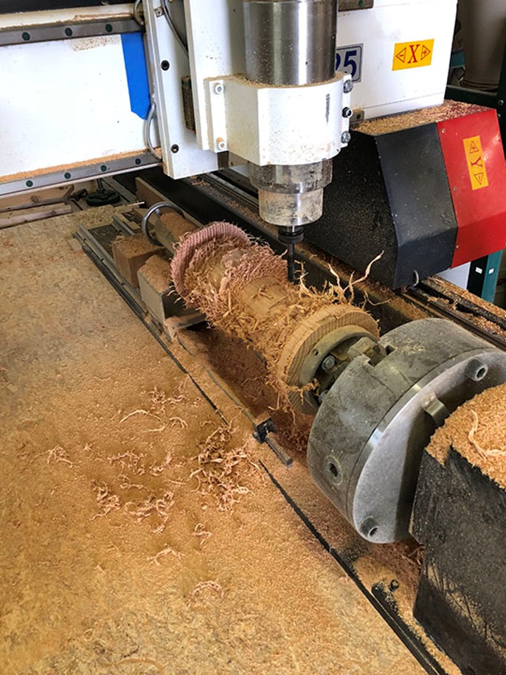

I needed 8” x 8” – 8’ beam to machine the legs. Although I wanted a prime grade of wood like maple, walnut or oak in that size, the only thing available around the Salt Lake City area that size was rough cut Douglas Fir. I could have ordered something else in but didn’t want to spend hundreds of dollars in freight. Each leg, using the rotary on the CNC took about 5-6 hours to machine.
I had four 2” x 10” – 10’ Douglas fir rough cut planks that I had laying around in my shop for about 10-years, that I knew I could carve the sides and not have a problem with warping. Those were used for the frame and sides of the rails. Cutting, milling and carving them took about 3-days.

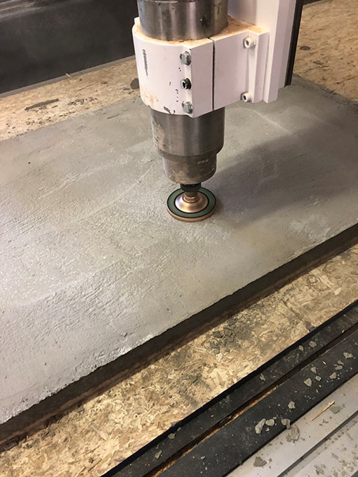

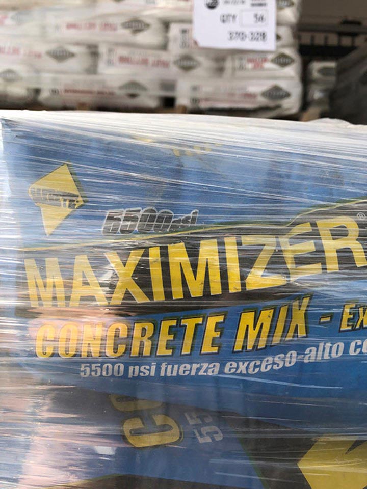

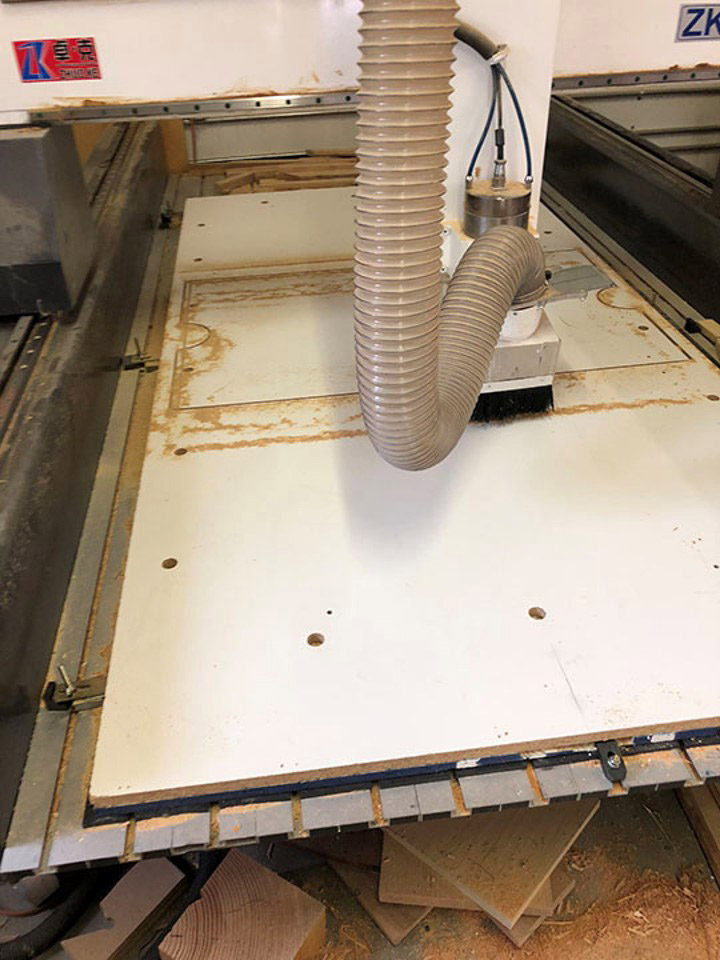

I could have bought the slate, but that wasn’t the point. I wanted to make everything. I watched a YouTube video about concrete countertops to get the correct type of concrete and additives. Since I wanted a perfect surface, I purchased a sheet of ¾” melamine for the Face Side of the form. I cut three sections on the CNC machine, cutting out all the holes and pocket formation. I used six bags of high PSI concrete I purchased from HomeDepot costing about $6.50 per bag. I also used some wire mesh to make sure the concrete didn’t crack. I screed and trowelled the cement making it as level as I could, however after it set, I had high areas. I let it cure for two days before I purchased a 4” diamond grinding wheel from Harbour Freight for $20, machined the end of a 5/8” bolt on my lathe so it would fit into a ½” collet to mount it to the CNC spindle. I ended up milling about 6 mm, mostly around the edges to make each section exactly the same thickness. It took about 1-hour per section to grind. It also took me about 3-hours to clean all the concrete dust out of my shop – glad I had a leaf blower and a lot of fans!

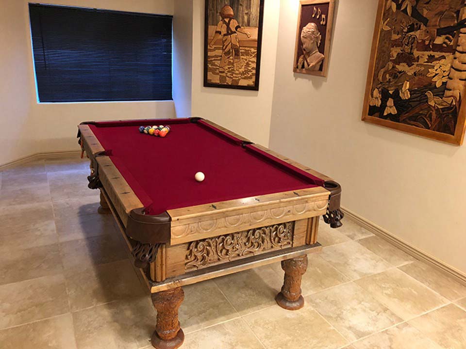

Once I moved the table downstairs, I filled the gaps with a flexible patching compound and bees wax. In my shop the concrete slabs were perfectly level; however, once downstairs, I did have to shim in two spots using a matchbook cover. All in all, it turned out great.
The side rails were the trickiest. I cut them using the table saw and router table. The first set, I used Douglas fir, however using contact adhesive, the rubber bumpers didn’t adhere very well. When I redid the rails, I used ¾” MDF, which worked very well. Using Aspire, I cut inlays for the diamond marks on the top plate and filled with resin. This resin was colored with walnut sawdust. The total time for this was a couple of hours.
In summary for the tooling and machining parameters I used a 12mm end mill for the rough cut and a 6mm ball mill for the finish pass. If I went to a 3mm ball mill for the finish pass for the grape engravings on the legs I would have been happier, but it would of increased the time by two or three days, so I didn’t do it. If I had to do it over, I think I would take the extra time.
One of the software features that really made things a lot easier for me when designing and milling was the new rotary machiningsupport within the new V9.5 version of Aspire. That combined with the 3D modelling tools and the already included huge clipart library allowed me to take the designing and machining to the next level.
Looking back at the project everything went as expected, except the rails, which I had to do twice. I would definitely get the leather pockets first before I start cutting. Not having them caused me to have to redo the rails. I have never been good at wrapping presents so the stretching and wrapping of the fabric around the rubber bumpers at the pocket ends didn’t turn out as well as I would have liked. I should have had a second person helping.
