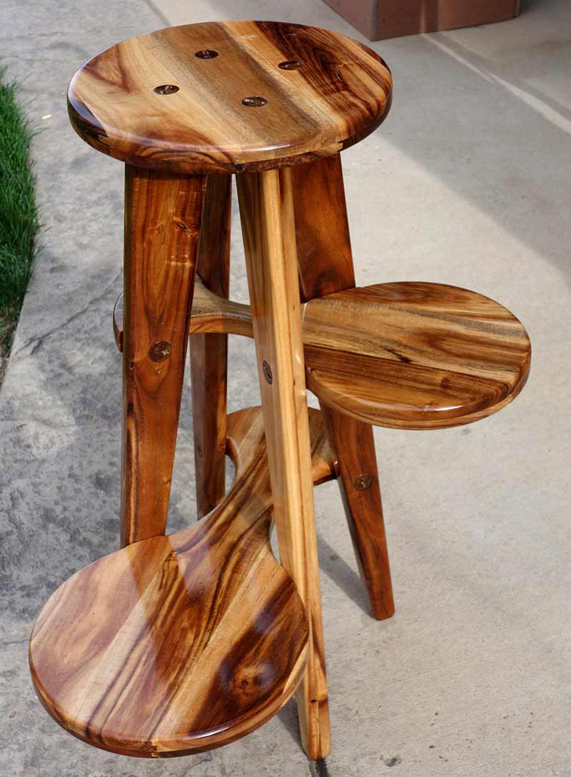

We moved to Colorado earlier this year (I made sure the house had a 1300 sqft shop space in the basement) and for the new dining room, we bought solid acacia furniture. However, there was an empty corner that we wanted to decorate with some plants. Looking over the usual sources we did not find something we liked or that fit with the rustic appearance of the other furniture. So, I decided to design and build my own plant stand.
After coming up with the idea and getting the materials together, Gert went to work planning and designing the project…
It is made from solid acacia hardwood. I really love this material with its wild grain patterns. It is very hard and dense, machines nicely without much fuzz, and can be sanded really smooth. Acacia is not oily like many other exotics and does not clog abrasives. It glues very well.
However….it is almost impossible to buy board lumber here (that I know of). Therefore, I ended up buying a box with 26 sqft of acacia hardwood floorboards at a local flooring supplier. They were 19mm thick but after planing off the back-side ridges and drum sanding off the top finish only 14mm thickness were left. It was helpful to have a helical carbide cutter head for the planer because this wood is very hard (2200 Janka).
With the planed boards (half of the box) I glued up the blanks double-thick (to 28mm) for machining the components on the CNC.
I hand sketched a few ideas of how to allow for 3 potted plants in a room corner and ruminated over that for a week. At some point, I focused on the barstool like design and how to attach the lower shelves to the legs.
At first, I had planned on using a glued mortise/tenon attachment. But the new Aspire version with threading tool path came out just in time to change my mind and consider a bolted construction with wooden screws.
The detailed design was made using IRONCAD, a mechanical design package that I have been using for 20+ years. Not as well-known as e.g. Solidworks, it has similar capabilities (and price…). I did not need 3D models for this project and transferred only the 2d-drawings as .dwg to Aspire. There I completed the 2D work for the hole circles, threads, nut recesses, and rounded bevel guide vectors.

Obviously, the threaded tool paths were the key feature I wanted to try out. But otherwise, I used pocket and profile toolpaths as well as moulding and drilling toolpaths. The moulding toolpaths were strictly for radius bevelling of the shelf and leg edges. This could have been done faster by hand with a roundover bit but, well, I do not have a working handheld router anymore….
I did all the profile, pocket, and drill cuts with a ¼” upcut endmill (the simple Freud brand carbide bits from Home Depot) at a modest 0.15” depth, ~12k rpm, and varying feed rate 40ipm for drilling up to 150ipm for straight cuts. Being a one-off project in unknown material I was rather conservative.
The threading was done with a Magnate 90-degree threading bit similar to #796 (not sure anymore which number exactly) and the bevel profile with a ¼” ballnose of unknown provenance. The only cut with an 1/8” bit was for the screwdriver slots in the screw heads.

After machining, all parts were sanded with ROS at 80 grit until all machining marks vanished, then 120, 240, and finally 400 grit. The total sanding time for all parts was maybe 2-3 hours. But after the 400 grit, the wood started to become shiny.
A first finishing coat of Danish Oil was applied and left overnight to dry. After that, the grain came out great and I normally would have left it at that, maybe with another oil coat.
However, given the intended purpose with the risk of water damage I gave all parts a generous layer of semi-gloss polyurethane varnish (Varathane Triple-Thick). It still looks nice but I do not appreciate the somewhat plasticky feel of the polyurethane.
I would like to do more projects with the acacia lumber but this is limited to smaller parts that can be made e.g. from cheap Acacia cutting boards. The glue-up method used for this project is possible but it took almost as long to plane, sand, and glue the blanks as it took for the rest of the project. I am probably not going to do that again.
The wooden screws and threaded inserts were cut individually while held in a machine vice. I did this mainly to avoid making a special jig for multiple parts. The downside was a LOT of bit changes (end mill for the bolt and head shape and threading bit) and part swapping. That kind of ticked me off and I would come up with a method of gang machining all required bolts and nuts (12 each) at one time.
As mentioned above, if not for the water damage risk, I would not use the polyurethane varnish on fine furniture. The Danish Oil (or tung oil) gives a much more natural appearance.
