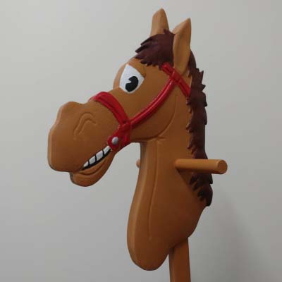

Several years ago, I made some Hobby Horses using a 3D model of a horse’s head I had and used it in a similar fashion but didn't video the process. I wanted to make another but this time with my own 3D model. With the 3D tools in Aspire I was able to create a horse’s head that I liked and away I went.

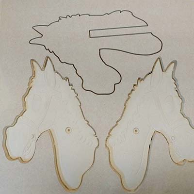

Creating the model was surprisingly quick and over a couple of evenings I was able to create the model and refine it until I was happy. The 3D modelling feature of Aspire for this project was invaluable. I have always dreaded 3D modelling but having done one now I can better see the process. I thought the most interesting part of the 3D modelling process was not the 3D process itself but the making the 2D files to base the 3D parts on. If you spend the time to get the 2D elements right then the 3D is much easier. My favourite feature of VCarve and Aspire is Moulding toolpaths. It has allowed me to create a 3D cut with minimum effort. It is a very useful tool. I know with more experience I could do it much quicker and better but for a beginner I was happy with slow and steady. Overall it took about 4 hours to cut out all the parts and assemble. Finishing, priming and painting took another 2 hours over 2 nights waiting between coats for them to dry.

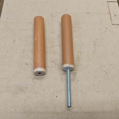

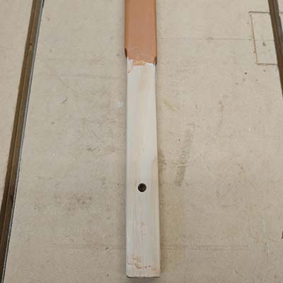

For the materials I used 18mm MDF for the body. Pine for the stick and 18 x 25mm pine from my local hardware store cut to a length that suits the user. In my case 1200mm, but I had to round over the edges and thin the stick to ensure a nice fit with the body. This is easier to do before the head is glued up. Also, most importantly a piece of 6mm threaded rod 100mm long.

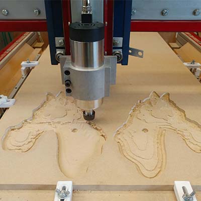

This project surprisingly didn’t require too many tools. I used a 1/4" down cut for the rough cut 100ipm at 10000rpm. A 3mm ballnose for the final cut 300ipm at 100000rpm 10% cutover and a
1/8" for the profile cut 100ipm 10000ipm.

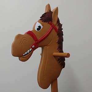

Even though I love creating this on my CNC for this project the painting of the horse was the best part. You can cut the same model over and over but once it is painted it will take on a life of its own. No two will be the same. With different colours and horse can look completely different. You can prime the finished model and give it to someone to create their own personal horse. This reminds me, a top tip for folks using MDF. Prime MDF before painting. It soaks in to the cut MDF and hardens the surface. Shellac works well and dries very quickly but still paint with a white primer before applying the colour. I find that paints look so much better over a white primer than direct onto MDF. The primer I used is water based but still works well.
