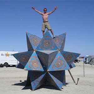

In 2001 after taking lessons from the works of Buckminster Fuller, Rob built his first of many Geodesic Domes. This lead him to other types of non-rectilinear geometries and research into the efficacy of their application to different architectural domains. In that vein, Rob went on to build a four metre tall stellated icosahedron called 'Spiky' that was featured in Mathworld.com in 2004. He constructed the piece from plywood and fabricated it in his garage with only a hand held skill-saw. It was around this time that Rob discovered what is properly known as a Zome in the wonderful book 'Shelter' by Lloyd Khan. Rob describes a Zome to us as,

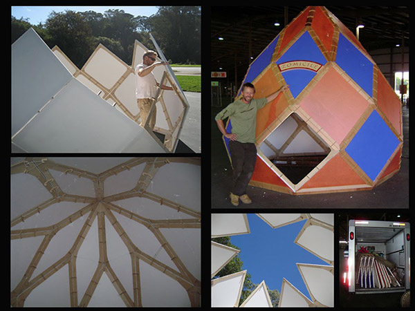

Zomicile
In 2007 I built my first Zome which I called the Zomicile. I displayed the Zomicile at the MakerFaire in Austin, Texas where it was awarded a blue ribbon! This structure was constructed of wooden rhombic frames and rigid foam panels. The tolerance control in VCarve Pro made cutting the puzzle jointed frames a breeze.

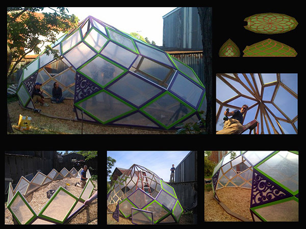

Algarden Zome
In 2008 I partnered with a Landscape Designer, Patricia Algara of BaseLandscape.com, to build a Zome Greenhouse in Berkeley, California. We called it the Algarden Zome. Each of the 84 panels was composed of two rhombic frames which sandwiched flexible, transparent plastic sheeting that was salvaged from a previous greenhouse that had collapsed. This time, instead of puzzle joints, the rhombic frames were assembled using a stepped lap joint which meant that there was a lot of pocketing to do. Here I was able to edit the tool stepover to optimize my pocketing routines.

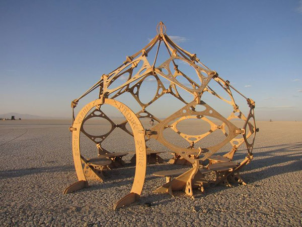

Bodhisattva Zome

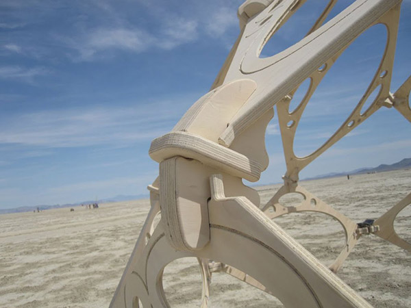

In 2009 I designed and built my first zome pavilion at Burningman. It was called the Bodhisattva Zome. It's a 14' tall open air pavilion with seven built in benches inside. Two people can assemble this Zome in less than two hours with only their bare hands. To date the Bodhisattva Zome has been assembled 12 times. Here I made extensive use of mortise and tenon designs. I perfected my technique of using layers to manage the many intersecting pocket regions I had to contend with. VCarve Pro's layer control allowed me to manage what would have otherwise been an overwhelmingly complex process.

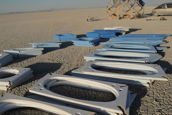

Zonotopia Zome
In 2010 I returned to Burningman with the Zonotopia Zome; a far more ambitious and complex structure. The Zonotopia Zome is twelve frequency structure over 20' tall with nine built in benches and three doors. To date this structure has been built four times - all with simply interlocking wooden joints and the bare hands of Rob and his ever growing crew of Zome builders.
