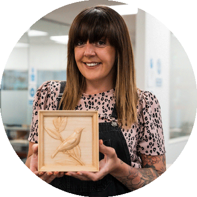

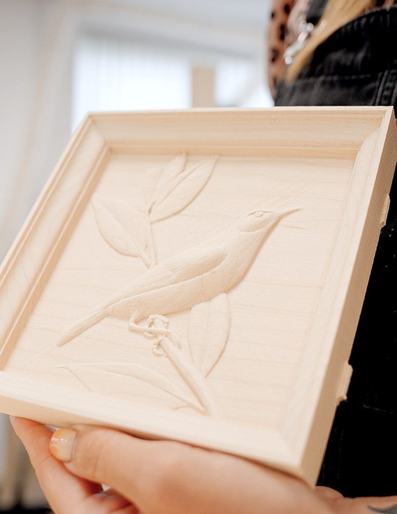

If you want to dip your toes into the world of 3D modeling in Aspire then this project is going to help you get started off on the right foot. Beki walks through the entire process of how to create this beautiful bird in a frame model.
To start she demonstrates the sorts of vectors you need to create whilst showing you how to create smooth clean vectors. With the vectors all in place Beki then takes the time to show you 3 key modeling tools, starting with the new v12 create round shape tool and how easy it is to build shapes to create the basic foundations of your relief. To then looking at the two rail sweep and the extrude tool. With the basic model created Beki then shows you how easy it is to bring the composite model to a state of finesse with a simple sculpt to blend everything together. To finish she adds the finished model to a frame that she created with the two rail sweep.
